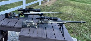

Paul, here is 2 22 GTs. A heavy & the light. I just put the light one together a couple of nights ago. Thank you for recommending Alex. I always thought he would be too busy. I mentioned your name. He’s got me on list for a 6 BRA & is also going through my action to make sure all is optimized.
Lynn
Lynn
Excellent, glad it worked out for you!
