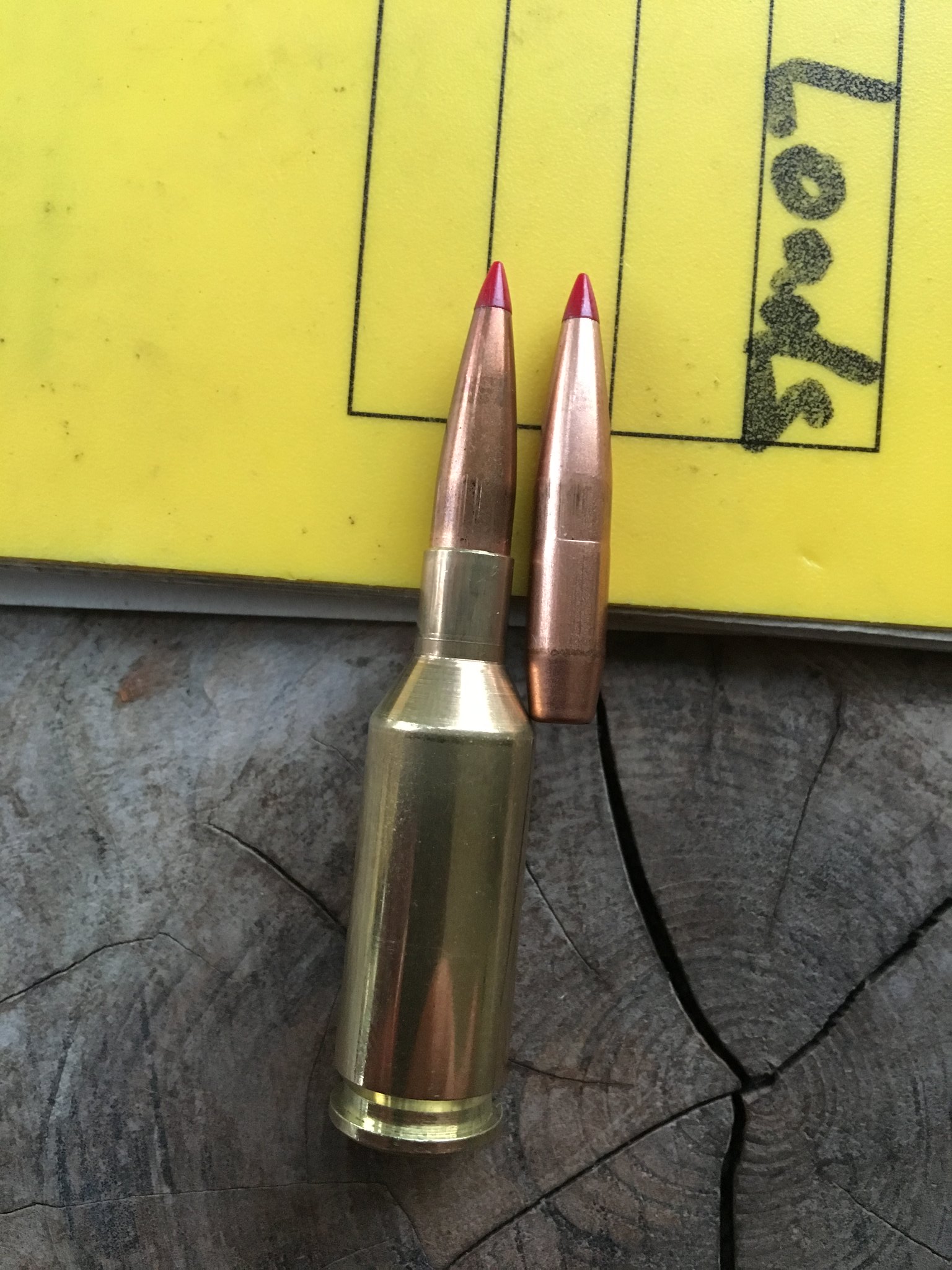

Just finished a .22br as mentioned here and elsewhere.
Kissing lands with an 88 @ 1.778" bto puts the base just north of the neck/shoulder junction but not 1/3 up the neck, and with the loooong neck, would not be a concern.
