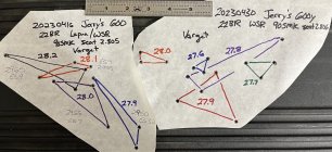

It was a pretty windy day today, but I'm pleased with the lime green group that ended up right on the target dot (grrrr! makes it harder to determine the bullet color). That itty bitty little group measures 1.074 inches. That's the second smallest I've shot at 600 yards, after the blue 27.6gn of Varget group shown above from 4/30 that measures 0.780". I'm always a bit amazed at what just a few thousandths of change in seating depth can do!
This orange 1.5" birchwood-casey shooting dot on top of a blank 3 inch black dot works very nicely at 600 yards. Good strong contrast that holds up in the mirage and a 1.5" dot isn't too big or too small to be swallowed up by the center dot on my Sightron SVSS' reticle.

It’s interesting to watch the groups spiral from 27.7 up to 28.4gns of powder. What do you guys think? I’m leaning towards retesting 28.0 to 28.3 to see how it looks.

I see a lot of vertical that I think is from a bad tune. The wind was not kind that day, but the vertical is more than that.
