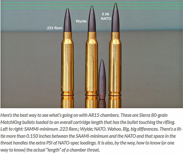

This is a picture I found online that helps explain the differences in the chambers.
As everyone else has said, it's in the free-run of the throat before the bullet contacts the rifling. The military wanted a small round with a big punch. To do this, while still staying within the pressure limits for the M-16, they cheated. They allowed the bullet an unusual free jump distance into the lands. This had the same internal ballistic effect as increasing the case volume. When Remington introduced the .223, they speced a more conventional throating.

Main differences are...
5.56x45 has wider freebore diameter than 223rem
5.56x45 has longer freebore than 223rem.
5.56x45 chamber has a little bit more generous headspace than 223rem.
5.56x45 can be (and often is ) loaded to higher pressures because of the longer and wider freebore.
If you take a 5.56 NATO loaded round and fire it in a 5.56 NATO chamber, the pressure will be around 55,000 PSI.
BUT... if you take that same exact round and fire it in a 223 Rem. chamber, the pressure can rise above 63,000 psi because of the chamber differences.
