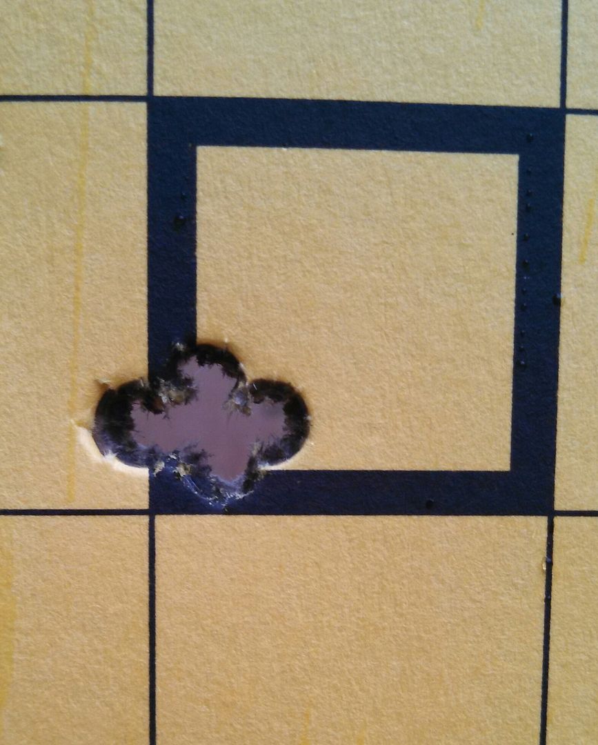

There's nothing wrong with an 8 Twist. I shoot a JP 223 with an 18" barrel using the 80 grain sierras and I believe 23.0 grains of Varget. This rifle just hammers.
Here's a 5 shot group at 200 yards and at the time was only the 3rd five shot group from the rifle after the break in procedure.
I shot neck in neck with a custom rifle at 300 yards shooting tums with this rifle.

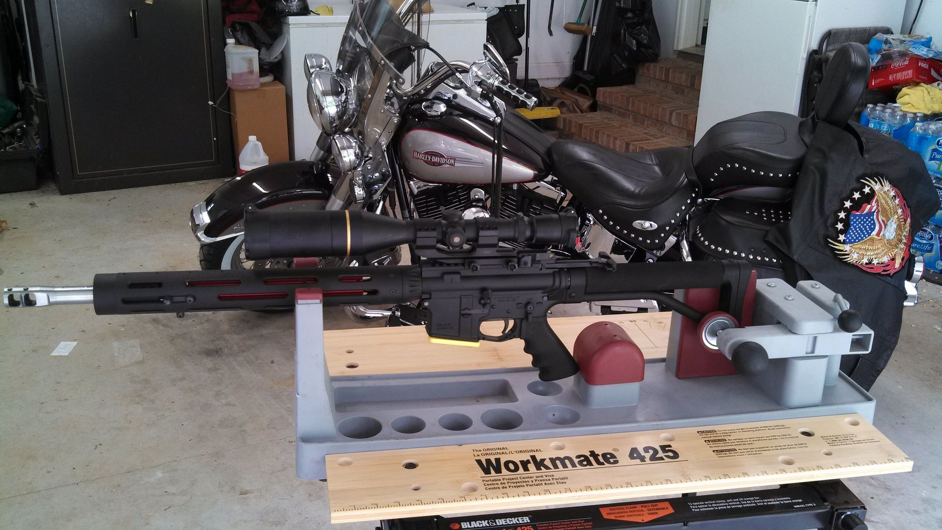

Here's the rifle.

Thanks Ron for the compliment. Yes the mags are standard length. I use the standard GI mags you can get from brownells for like 6-7 bucks. I just seat my bullet as long as I can and still function properly with the mags. The 77's from Sierra are designed specifically for magazine length AR's
