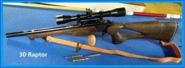

I'm into the 30 Raptor now

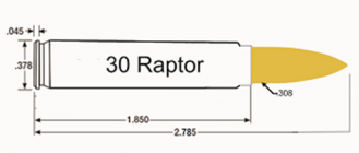

Do you have a pic of the rifle?
I do not. He wrote about it, i kept it in my head because i research (and own several) Superiors, but he passed, his wife never returned an inquiry I made, and it was not photographed in the 2nd part of the only article I ever read in PS. I never saw the first.

How does the 30 Raptor compare to the 300HAM'R from a case dimension/power volume? How do you form the brass for the 30 Raptor?
Right off the top the 300HAM'R has a longer neck, and the 300HAM'R cases can be formed from 223 brass by shortening it (cutting off portion of 223 case at the neck/shoulder junction point).
Thanks
As with all cartridges designed for AR's OAL dimensions have to be considered.
With Reeder's designs, he is given more latitude. The Raptors use full length 204 Ruger brass and are afforded more case volume.
I don't use the 300 HAM'R but have been really impressed in what I've read.
A longer neck is always a benefit for bullet seating and Reeder, I believe, changed his neck design in the Raptor line between his introduction of the 240, 257, 6.5 and his later 7mm, and 30 Raptor.
The three earliest Raptors have a standard neck length like the HAM'R, while the last two have a short, to offer expanded capacity, neck.
I hope I answered at least part of your question, lacking specific statistics.

Thank you for the comparison of the two cartridges. I hadn't realized that the Raptor was based on the 204 Ruger case, which explains the additional case volume. The reduced neck seems to be geared toward a single shot action or bolt action.
I actually use 223 Basic from Starline when it's available, a recommendation from barrel's previous owner,
to create a slightly longer neck for more bullet support. Doesn't seem to have any adverse affect on chambering or performance since cartridge headspaces from shoulder. Although the photos depict 204 Ruger brass donor.
Recently graduated to the Encore so more diffusion of contender concentration expected.
