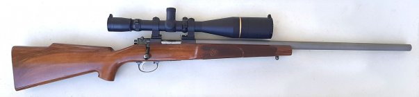

The rifle I purchased has a Hart heavy stainless barrel, so it's not the original Sako barrel. The rifle is new to me, and I did not receive info as to round count on this barrel, but it appears to bein in great shape. I don't have a bore scope, so can't comment further as to how the throat looks. Crown looks great.
Well that shoots my theory about the barrel. Stock bedding might help. Also I’d try h4198 with Sierra and berger in 52 grain bullets. If that don’t help and it was mine I would trade it off.
I have seen quite a few sako's w 14 tw hart barrels shoot extremly good.
Like it's been said a good 52-53gr bullet
Sierra, berger, barts. It won't take long to see if it shoots.
H-4198 is magic. But i haven't seen any in a few years.
Watch the flags very closely. The 222 maves a lot with little to no wind.
If you run down all the options above and still don‘t see an improvement, I would try a different VMax, maybe a 40 VMax or a Sierra BK?
All of those mechanical troubleshooting steps are good suggestions and one may turn up to be a cause. We all know there are some odds that everything is sound and the barrel won’t do any better with this bullet.
Sometimes a barrel just doesn’t like a bullet that we want it to, but then comes to life with a different one. Don’t be afraid to test a different bullet. It needs to be one you are willing to use, but let’s face it, if you run down all the troubleshooting list and also run a different recipe and the rig still won’t make you happy… life is too short to stay married to a barrel that won’t make you smile.
