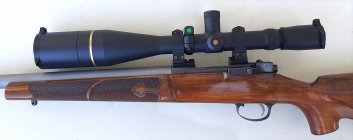

The scope I have is a Leupold 6.5-20x50mm with Varmint reticle. It's a recent purchase off Ebay, so I don't know for sure it doesn't have an issue. The rings seem to be a good height for clearance, thought of getting some Leupold Sako mount rings to replace the 2-part set-up on there now.

If your grouping well with another rifle on the same set up my guess would be your set is fine and there’s another issue amiss.
I’ve had good luck with Leupold rings on my Sakos, just commenting since you mentioned them. They hold zero well and make a lot more sense to me than many of the other offerings for Sako, Sako’s Optilok rings included. Simple and effective.

I'm thinking I'll see if I can get the right height Leupold / Sako mount rings and replace the two-part Weaver adapter and Warne rings. I have those Leupold rings on my 20VT and they are really nice. The 20VT has a 40mm objective, this one 50mm, so I'll have to go to the next higher rings at least.
Scope does not look overly high, but the extra interface of that adapter would be nice to get rid of. In your rest set-up make sure you keep the rear bag clear of the pistol grip- i like the bag where the stock butt is ~2 " from the back of the bag. Also I would shift the rear bag away from the benchtop edge to minimize contact with your body. Good choice on the Wichita - hard to beat. FWIW I remove the sling studs for benchwork so I am not forced to compromise bag placement.

I just found some correct height Leupold Sako rings on Ebay, and purchased them, so one problem solved!
