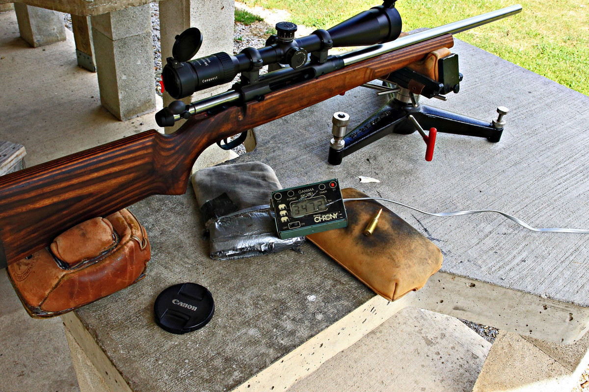

The one in the picture, it is a lightly brushed aluminum finish, just enough to nock the shine off. I am tempted to polish everything, the stock, action, and trigger guard, I cant find Kelbly 1" rings in the tall or medium height, but if I do and they are in the white, we will powder coat them in gloss black.
Right now the brass looks like my big holdup! But I talked to Lapua a couple days ago, and they said it is still on the manufacturing list, but no idea when it will run again.
I bought 100 rounds of the Nosler 17 fireball brass to get it, it was all I can find and all it needs is run through the Mach IV sizing die and .010" trimmed off the neck and good to go. I will be watching for the next run of 221 Fireball as well for it, Unless I get lucky and the Nosler brass turns out to be as good as Lapua, I will be standing on the throttle on that rifle,, not holding my breath on that one!
I bought 100 rounds of the Nosler 17 fireball brass to get it, it was all I can find and all it needs is run through the Mach IV sizing die and .010" trimmed off the neck and good to go. I will be watching for the next run of 221 Fireball as well for it, Unless I get lucky and the Nosler brass turns out to be as good as Lapua, I will be standing on the throttle on that rifle,, not holding my breath on that one!my wild
