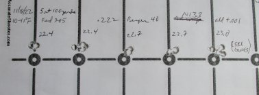

Think i'm going to order a pound of N133, H332 and see what shoots better. maybe ill get equal results and go with the cheaper one. I've also wanted to try bib bullets so ill contact him. I think ill also get some Ammerman bullets as a substitute for the bergers.

Powders in that burn range are best candidates. For decades, the go to load was with 20 or 20.5 of 4198. The n130 is close so certainly worth a try, as is lt30. I'd also try n120 for sure. Should be perfect. The problem with a 222 is not the cartridge but the timing of available best options. Not talking varmint loads but most accurate. Hopefully you find or have something that shoots great. RL7 is another good one but...you know the drill. Good luck finding it if you can afford it. Lol! The 222 will shoot tiny, especially at 100.

I've shot groups in the .1s and .2s from an old sporter weight 700 ADL with the 40g vmax and IMR4198
