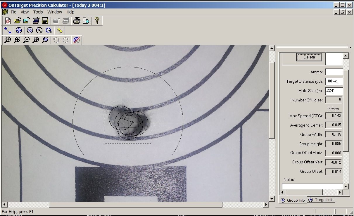

a year and a half ago, I purchased a 223 Rem 26"bbl that I spent 6 months trying to get under .500 at 100.
bedding, lap bolt lugs, trigger, crown, you name it, would not shoot below .500 no matter what powder, primer, bullets I tried, - gave up,
sent it to Wally and Bobby Hart, they scoped the Rem bbl and it was ok, so they trued the action and re-chambered it to 222m, .200's groups now with 52 Sierra, my B&A 53's and velocity in the 3500 range without pushing the pressure. h4198, 2015, h322 seem to be very similar in performance. 7 1/2 primers, Rem brass.
Some things old are just plain good.

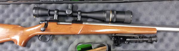

I also campaigned a 40XB BR in .222 Mag, back in the mid 1970's, and did well with it. Retired it from bench, took a block plane to the flat bottomed wood stock, and it did well against furry and black feathered friends. I still have it....
... and it still shoots well, with 50gr BlitzKings.
