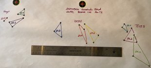

Pretty windy day today, but warm: 50 degrees. Wind was a pretty steady 15mph with gusts approaching 30mph. It felt like a lot. I set up at 500 yards after rezeroing at 100 since this is a brand new barrel.
This is a new bench design for me. Has to be manageable to lift in and out of the truck, handle uneven terrain, and be stable. It wasn't too bad but you couldn't do a jig behind the gun and have the crosshairs stay planted like with a concrete bench. It'll do for now.
2 shots of 25.0gn of Varget was a result of my poor planning while rezeroing and "breaking in" the barrel. I'm not a huge believer in it, but I cleaned at shot 3, 10, and 19. Here are some speeds, but keep in mind this is virgin brass and a brand new barrel:
Varget: 25gns 2600fps, 25.4gns 2670fps
H4350: 27gns 2580fps, 27.4gns 2640fps
TS15.5: 25gns 2550fps, 25,4gns 2600fps
Nothing showed signs of pressure and I consider this a huge success even though it was a little anemic. With absolutely zero data available, not blowing my face off was priority number 1. The smaller groups are all right around 1 inch, which is promising.
So the actual cut chamber neck size is probably a bit larger than 0.250". Maybe 0.252", which would be 0.007" over a loaded round. I'll have to see if the necks get hard faster than usual with so much clearance.
The loads weren't too low a pressure, because the necks sealed up nicely and didn't get sooty.
"Hot" windy day today at 65 degrees. I needed to put up some shade. I also humped the target out a bit further in a different spot - 685 yards. I'm still rocking a Magnetospeed, so you'll see a bunch of unmarked shots below that were Magnetospeed shots. I then pulled it off to shoot the marked groups.
Thought this picture was kind of cool and it showed what sort of mirage there was.
I really like how often low-slow groups impact above faster ones on the target at distance. Really reinforces my belief that the chrono is not much use for determining good loads.
Speeds are still all over the place and too low, but I'm not getting pressure and I have another 100 pieces of brass to fireform so I'm not worried. Group sizes look promising, particularly the seating depths of 9 and 12 show me the 22PPC and this barrel in particular has what it takes.
