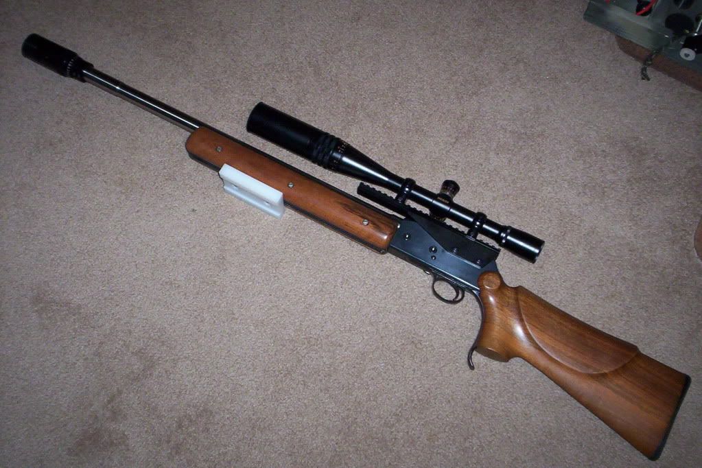

I own a MT Guns Martini International Mk III (the only model with a free floating barrel. MT Guns re barreled it and added a Hoehn tuner before I got it. It is the best shooting 22LR rifle I have ever owned and I have owned a number of expensive 22 LR's over the years. The barrel is a 3 groove Benchmark SS barrel with a 16.5:1 twist.
I also own a a MT Guns Anschutz 54 with the same barrel and tuner. Although it shoots great, it does not shoot as well as the Martini.
George
Tavelor, Minus the tuner and Delrin block and his appears to have a heavier BBL they look alike...... Unbelievable trigger, and SUPER balance.....
Travelor/George,
Here I was trying to make a comparison between a Suzuki and a Lexus and you come along a drop in a Ferrari...hmmm, not fair. But that rifle is definitely a beauty. One of my shooting partners has one and I don't even bother to try to shoot against him as I can atest first hand how nicely and accurately a Martini, such as your's, shoots. It was seeing that rifle shoot "free recoil" that made me a believer of just how accurately a finely tuned Rimfire Rifle can shoot. Over the years, it's been my pleasure to see several different Rimfires shoot in the hands of very capable marksman and none have produced the results of those Martini's. They are a "keeper" in the true meaning of the word.

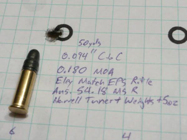

Anschutz 54 match of one type or another, as long as it includes the 5018 Trigger. Mine is an Anschutz 54.18 MS R. No better repeater .22 made under $5000....maybe no better made at all..
Harrell Tuner bored to fit your muzzle diameter (should be ~0.850-0.900"...use a micormeter, and measure several times for taper and/or out-of-round)
Additional Weights for the tuner... Killough Shooting Sports has both tuners and weights and boring.
Decent scope in killer rings....I recommend the Kelbly single-bolt standard height rings in "rimfire" rail. Call them to order. Annie rails are 11mm, but just tell them it for an Annie.
Eley Black Box EPS "Rifle", Elex Red Box EPS "Rifle", Eley Yellow Box Target. Get several boxes to a brick of the "target" for testing your tuner, as it will very closely approximate what the more expensive Match and Tenex EPS rounds will need, but will not cost you $20 a box to test.
The results of a well-tuned Anschutz with ultra-match ammo are..ummm..eye-opening.

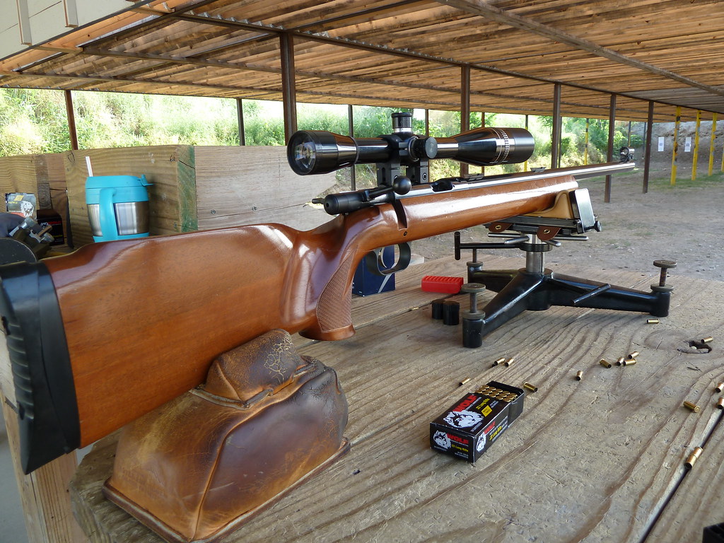

Ruck Prone with rear sand bag, this afternoon:
That's the best group of the day, admittedly, but I tested another lot of Eley Black later, and posted another 0.182 MOA group...it's not too flukey...not with this rifle.
-Nate
Thanks, Dennis. I feel pretty okay about that level of performance.
I know the BR crowd can shave some off that with rests and benches and upgraded (tighter) bore rifles with true EPS chambers...and I could too, if so inclined...but that's not too bad for a factory barreled action.
For a point of reference, the same rifle with Eley Yellow Box "Target" shoots into solidly 0.400-0.475 MOA when tuned. At $5-7 per box, it is a lot cheaper way to "quick tune" the rifle before moving to your lots of Black Match or Tenex Red.
