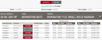

Check out load data for the .225 Winchester.
