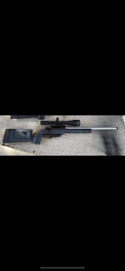

I saw this post a year or so ago and had to have one. I use lapua 22-250 FF brass with any large rifle primer i can get hands on. H4350 and sierra 77gr HPBT. 20" K&P barrel and ARC nucleus action. This thing shoots as good during fire forming as after. Txhillbilly's rifle was my inspiration.
