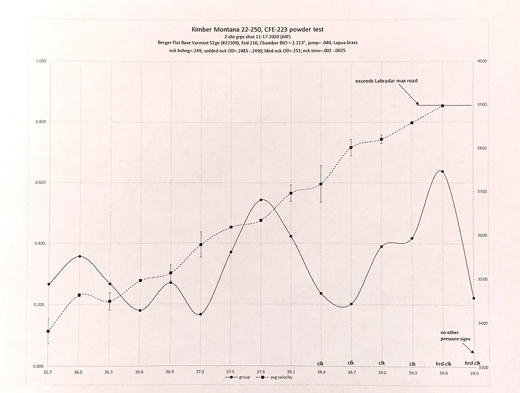

Got a new-to-me Kimber Montana in 22-250. While running through a range of charge weights with CFE-223 using virgin Lapua brass to find max pressure, I started experiencing "clickers" way before any of the traditional/more common pressure signs started to show. This is the first time I have loaded for this cartridge, the first time I've worked with Lapua brass, and the first time I have ever experienced clickers.

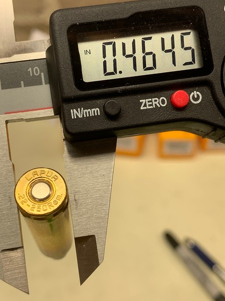

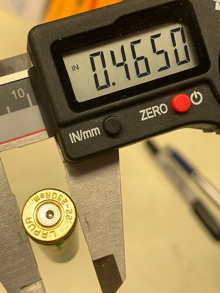

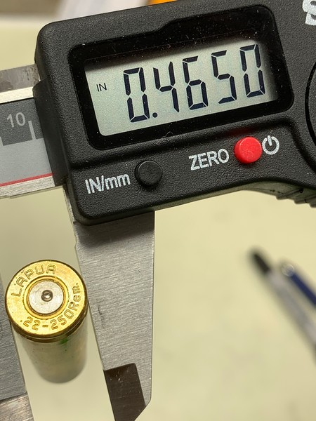

The web of the Lapua brass expands about .001" on the first firing in this rifle. Running this first-time fired brass through my Redding full-length resizing die, the web is sized down about .001" There is a bright ring on the re-sized web, suggesting to me that is where most if not all of the re-sizing is occurring. Since the brass is being resized back to the size that originally gave clickers, I am expecting to get clickers, again. The bolt is a little stiff when chambering this re-sized brass, too.

This from a similar bullet, Berger Flat Base Target. I was going to refine jump for the Berger Flat Base Varmint once I found a powder and charge weight. The bullets are so close in design that I figured it should be a good place to start. You can see I was getting clickers during this jump test, too.

IMO it is not a die issue(but I would like to know how much your FL die reduces the base of the case). It is a unfired brass to chamber fit issue. Note in previous post the difference mentioned between the Lapua and the Remington. .005 is significant. I would be that the difference between Winchester and Federal would be similar.

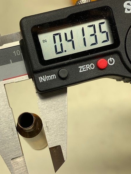

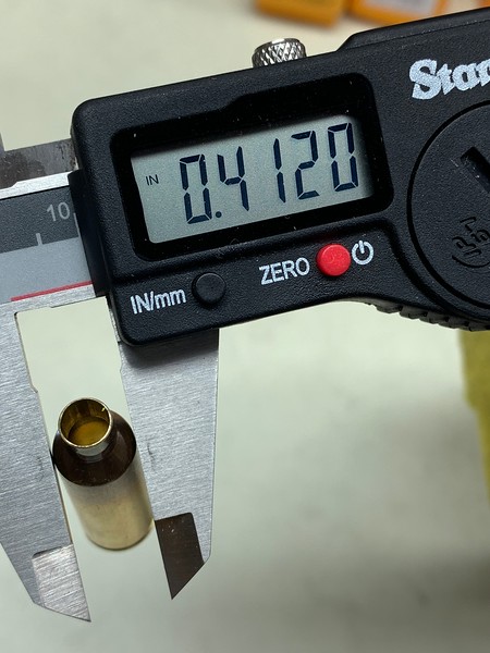

Great pictures. Can we get some unfired of other brands from anyone on this thread? Just for fun, and unrelated, take a look at shoulder diameter, virgin to once fired, to sized. I think that you may learn something about this caliber.
