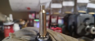

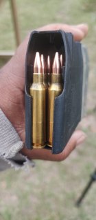

If your brass has that bright ring you show in your snapshot, are you familiar with using a probe made from a bent paperclip or stiff wire? A wet tumble and borescope in the cases is also a way to eliminate the worry that those rings are from the brass "necking" down in that area in what is called incipient case head separation.
I have had ammo boxes buff the brass at about the same place, so play it safe and double check to make sure that brass is okay. Good Luck and in for the range reports.

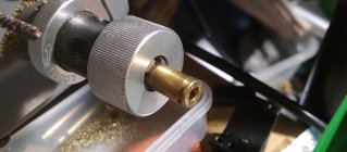

Your ammo box statement made me think a lil and realized it could be from my trimmer ! Noticed about all the brass I use this thing on end up with one of those rings right where the lil collet makes contact

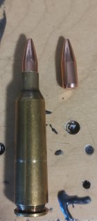

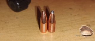

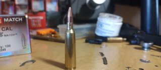

picked up some of this magical powder eveyone keeps talking about and a box of these 52 gr BTHP's. Think they will be the best thing I could ask for given all the constraints a 1:14 twist gives a guy. But yeah this 380 is supposed to be the best thing since sliced bread for the 250

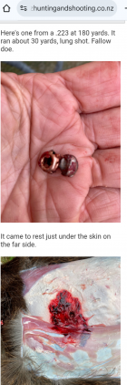

Next to one of the 55gr SP's... Which onna side note , I was reading and apparently the cannulated 55gr HP's work better , terminally wise ..... Folks think it's because the cannular works kinda like this deal on a nosler partition....KINDA ...... Sorta kinda ..... In a very liberal sense lol
And with more reading I see the 55gr is a favorite across the pond seen a lot of talk from Brit and Kiwi deer stalkers liking them . Especially because there usual lack of a pass though

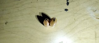

Anyhow will say I noticed the 52gr BTHP's have a bit of a bigger HP then something like my 69gr BTHP's

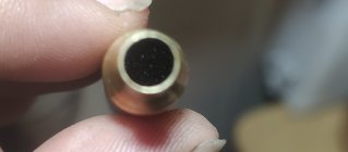

And a quick look on the inside
Found these hieroglyphics in there lol
And looks like this cleaned up nicely

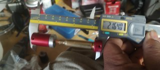

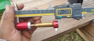

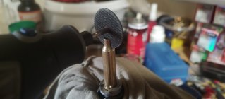

New bullet = new seating depth so making a little split case to find my jam..... Now let's be clear I AM NOT jamming my bullet nor want to I just wanna find my rifling SO I CAN STAY OFF OF IT
Any way sized and prepped case Dremel

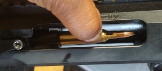

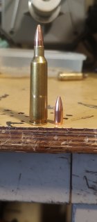

So , how this works , the cut allows you to ad or release some tension on the bullet , ya want enough to hold the bullet and let it slide back with a decent bit of effort...but no so much that it will allow the bullet to stick it too lil it just plop out. Anyhow stick it in long ,measure it
Fit the case on the bolt rim under the extractor and hand feed it in it it chambers
Gently pull it out and take that measurement. Do that a few times get an average an That's where your hitting the rifling .do with that what you may I like to BACK OFF the lands like .003

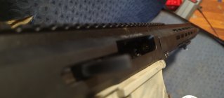

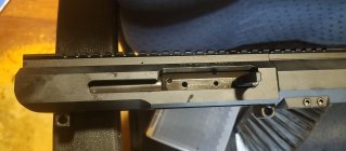

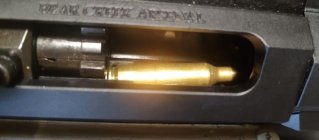

Now.... something I thought about was that when the gun actually runs...the rim of the round does go under the ejector till it's in the chamber and the bolt is slapping the back of the case .... As shown
some mabye ... Something might be different maybe I should try it ... So too that dummy plopped it in the chamber dropped the bolt release like I would if I was reloading a mag and
Yeaaahhh that's a bit different so.... I basically have two different deals now j can work off of and since the second is more like how stuff actually works...guess I do that ! So ended up running like 2.045, yeah that's supposed to be jam....but it ejected fine and easy with no marks ...so ... It can't be jammed idk..

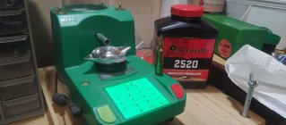

So as far as powder I WAS going to use some of the magical H380 buuuut apparently that's only for like 55gr and up so we'll have to wait , BUT again I have the options between accurate 2460 and 2520 and since 2520 gave such good results last time just gonna run with that
And gonna go up a bit because this 20" barrel is loosing 300fos or so vs what the book says
IMG_20251106_123525278.jpgIMG_20251106_123559022.jpgand not a ton of case fill to start

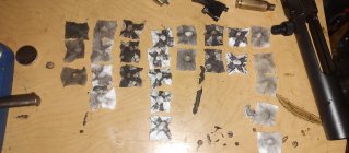

6 groups and all but one I think is sub MOA
Velocities are on the lowered side for a 250 but again ...20" barrel feel like I could stomp on it a lil harder and play with it some.more but this is bolt gun data and this is a gas gun so..... Not the safest thing to do....soooo guess the question is now ...which load ?
Sure looks like the vertical dispersion is reducing as charge weight increases (see this regularly). Perhaps a test with 35.2 and 35.4 to further reduce the vertical.
