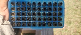

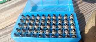

Okie dokie and today . 15 pieces left . Haven't cleaned the gun past getting most of the powder out but only had 15 pieces of brass left so ..egh.

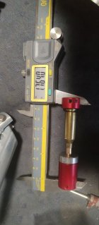

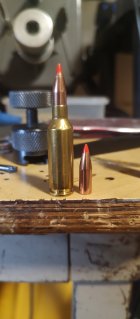

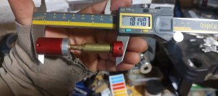

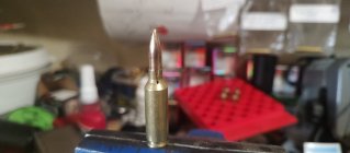

But I guess I work up with a little more sense this morning and used one of those spent converted case to make a split case . Now idk what the actual name for these are but I just call them a split case . All it is is a way for you to find your jam...or where your bullet hit the rifling. Just take a case cut a slit down to the shoulder with a Dremel,pinch it a lil so it holds a bullet with a lil grip and chamber it with a bullet seated long. When it hit the lands the bullet gets pushed into the case and the tension keeps it there so you can measure.... Idk why I'm explaining all this it's probably something about all y'all have done lol
Did it a few times and 1.764 is jam so gonna just do 1.760 for a .004 jump...lil much but should definitely keep us from sticking

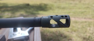

Stole the break off my .223 Wylde I never shoot because this lil guy has some upwards buck. Recoil isn't heavy or hard just you shoot and be off target

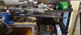

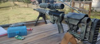

Moved the scope around a bit and. Got this goofy deal found on with the bippod where one leg is longer then the other but works better then both evenIMG_20251105_121424955.jpg

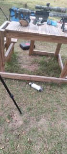

image_cropper_1762398660534.jpgIMG_20251105_131322428.jpgIMG_20251105_131531855.jpgIMG_20251105_131542180.jpg
So ....so far growing pains of getting this ting running decent aside ..... I'll be honest.... I don't get all the hype .... Don't get me wrong , yeah I'm slinging these a good 300 fps faster then my .223 and 5.56 with the same bullet .... But other then the fact I'll be able to keep going heavier and he we bullets MAG FEEDING .... Eghhhhhhhis it worth getting a while new upper or build as like a necessity deal ....I don't feel so , unless you need /wanna be in the bleeding edge of stuff constantly..

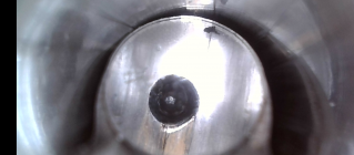

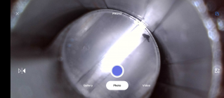

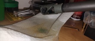

Ok Ok so back at it like 55 rd in and gonna give her a cleaning ..squirted some hoppes down the bore aannnndd got blue after a few minutes...which I don't get usually. Usually it's black
And some bore scope pics
Screenshot_20251106-190853.pngScreenshot_20251106-190925.pngScreenshot_20251106-191029.png

Took the scope BACK off my 22-250 .....I should really just buy another one for a floater so had to re sight
50yd looked good . First was low then a nice lil bug hole

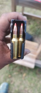

... problem is now ... It's back to not ejecting or doing a last round hold open , it's feeding but ...yeahIMG_20251107_114155579.jpg
Perfect ejection but I'm kinda sick of fiddling with this thing ...

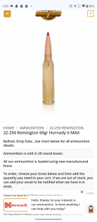

As far as bullet , next heaviest thing I had a lot of was the 60gr VMAX and apparently for .22 cal this lil dude is the best out of all of them apparently they're not AS hyper explosive as the lighter ones so

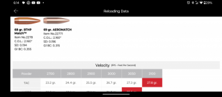

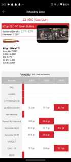

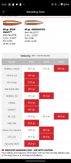

Now I was looking for data on the app but...Hornady didn't have any for the 60gr VMAX... For some reason, they have data for most of the 50 somethings the 62 ELDVT and the heavies but not the Vmax ... Thought that was odd
But figured I'd use the 62 gr data and just keep an eye on the brass . If anything I would get a lil more velocity with the lighter bullet .... Kids please don't do this follow the book I'm probably going to blow my face off one day
Something else that made me think was maybe it's not in there because possibly the 60gr is one of those that you can't push super fast in a fast twist .....but then I did som googling and tons of people run it in fast twist .22-250's even having some boutique custom stuff you can buy so it can't be that so who knows
