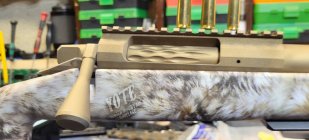

Finally, after 12 months.
Faxon Firearms FX7 action
McGowen Precision Barrel 28" 1:7
#4 contour, straight flutes, 5/8"-24 muzzle
Greyboe Stock and bottom metal
Rifle Basix trigger
Vortex Razor GEN II 6-18X50
Arken EP-5 7-35X56 Gen 2
Pulsar Trail XP38
75gr Hornady VMAX
80gr Hammer HHT
85.5gr Berger Hybrid
90gr Berger VLD
90gr Sierra
H4831SC
IMR7828SSC
Ramshot Grand
Winchester StaBALL HD

Well I like the 22-250 and the 22-250 Ackley Improved a lot,
thanks for sharing the pics.Kinda nice that you didn't succumb to the 22 creed more. Bet it shoots well, not sure I'd fireform with those expensive bullets though. The brass looks nice,Lapua or did you anneal them like Lapua does. Your probably gonna fireform on chucks with the 75 vmaxs anyway, so I'm just playing along with this pointless thread ;)

Haha thanks Matt!
Yes, Lapua brass. I annealed them myself with the Annie Induction Annealer.
Regarding fireforming, my buddy convinced me a few years ago to use Bullseye powder, beeswax, and dental wax!

So, I've never had to deal with fireforming, but I will be doing AI versions of my 22-250 and 6.5x55 in the near future. How does the beeswax come into play? Looks like the sheet of dental wax is pressed into the neck to seal the case..
Large pistol primer.
12gr. Bullseye powder.
Beeswax pellets from eBay, fill to the top of the case mouth.
Seal with dental wax.
Shoot in a safe direction. Ear pro necessary.
