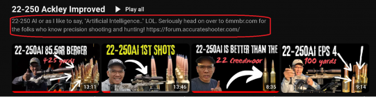

Since I have gleaned so much great information from 6mmbr.com over the years, it was time that I gave back! On my 22-250AI Video Playlist, I have added a link to this great forum!
