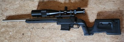

MDT chassis
Asic polymer 10rd 223 mag
It was a savage model 12 left hand action just to make things a little more difficult to find originally a single shot rifle. Its chambered in 17 fireball
Now its a repeater and its awesome..
Ejection would only work if i pulled the bolt back fast or the case would fall off the bolt head. But not any more..i just kept playing with it ..
MDT suggest using the metal magazine and adjusting feed lips. For what its worth.
I already had some polymer 223 mags so i figured i try them before spending more money first..
I cant confirm anyone else's rifle, but in my situation, with my parts, and rifle configuration it works...there is an over sized part available for the savage bolt that help that little case hold on. That i installed years ago..maybe that has something to do with my configuration functioning
