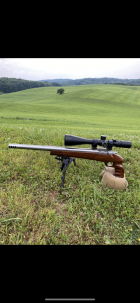

I put together a custom 22 Dasher and it is amazing. I cannot say enough good things about the new Berger 85.5 gr Hybrid Target!!! There is alot of work in making brass from the Lapua 6 BR brass however, I bought a box of Alpha 6 Dasher brass that I will neck down and turn.
-Krieger 7.5 twist at 21 inches
-Lapua brass
-Wolf Small Rifle Magnum
-2930 FPS single digit ES
-34.3 H4350
- .022 off
I am capable of running to 3100 without pressure; all the accuracy and precision is between 2900 and 3000 with the Berger.
Worked up loads with 80 gr SMK and 80 gr Nosler Competition J4 that were no comparison to the Berger, wasted components and barrel life because I couldn't source the Berger bullet that my reamer was based on.
Attached are some loaded rounds and a nice 5 shot 500 yard group.
This little Dasher amazes me and I regret not getting into one sooner.
