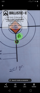

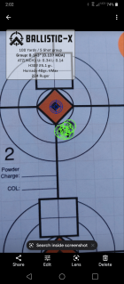

Think I found a load I can live with....
H322- 25.1 grains Over a 40 gr. Hornady Vmax
