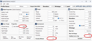

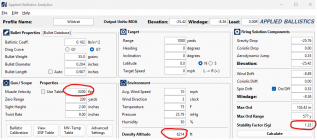

To show the model of why it works, I'll use the AB software that calculates the SG and exterior ballistics and happens to have a very good model of the Berger 55 in the library.
I guessed a MV of 3200 for this model, and you can see the 1:9 twist does fine at a DA of 6200 ft. At sea level, it may drop to an SG of closer to 1.1 where you would be sensitive to wind and the slightest defects.
Now put the altitude near sea level and we see the SG drop significantly.
