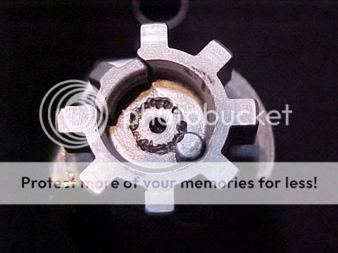

As a side note this is done on AR15 rifles, these rifles are over gassed and can pop out the primer and it ends up in the trigger group.
And loose primer pockets can also erode the bolt face from leaking primer pockets.
The photo below is also from AR15.com and the poster said he didn't worry about loose primer pockets. And he would just change the bolt when it got bad enough.
I reload for my sons AR15 and dad isn't going to be blamed for stupidity and a etched bolt face.
