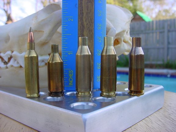

pictured L to R : 17 Fireball, 17 Little Nasty,PPC -.180" short), 20 Beggs, 22 Beggs, and 220 Russian.

Cajun Blake - the 20 beggs looks like a sweet deal. I read about the 22 and 6 Beggs rounds over on Benchrest Central. I have a lot more work forming, turning etc, but what the heck, just a few more hours at the reloading bench - there's worse places to be. I really like the Little Nasty you show at the bottom... I've enjoyed a 17 Mach IV for many years but haven't every considered any other 17 cal wildcats. Something to put on the back burner.
