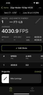

Working up a load for 20-221AI with 39gr BK-
20.1gr was a little hot-4030fps
I backed it down to 19.9gr LT32- did take a drop tube to get it in there- I stick with this 3986fps load… for the summer months..
