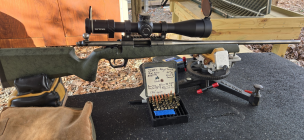

These cases were primarily built off of new Starline brass, didn't feel the Lapua brass was worth the difference. I am feeding single as I haven't gotten this to feed reliably from a mag so may have to try a Sako or CZ action at some point. I built this specifically to shoot 40gr Vmax but will have to try some Bergers.
Here is a pic just to show the size of the case. I had just dropped this barrel back on this action and added weight to the stock, shot a 10rd group at 100yds. It was cold out and this was also my warm weather load so maybe actually running just a bit slower as I didn't have my chrony up. Out of curiosity, have you tried N110? I just love it on my small cartridges.
As I don't know anyone living around me that I can go out and do this stuff with I just have to play and learn a lot on my own. It would be great to live around you and others that do this type of playing. Lol It is great to talk with others from this site and others that are willing to share info. Thanks again for the great info on this and other threads.
