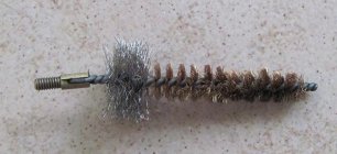

Right after I finish shooting, while the barrell is still hot I squirt brake cleaner down the neck. You can get a can at Walmart for $3 will last you months. I also use this brush, I dip it in bore cleaner rotate it several times in the throat, I let it soak while I run the wet bore brush. I let soak for about five minutes and then clean everything. The bore scope tells the tale. Every couple hundred rounds I use JB Bore paste remove all the copper while it polishes the bore. I also give a final coat of Kroil, that makes cleaning much easier next time around.
The kroil is a penetrating oil, it penetrates steel and skin, so use gloves unless you want to hurt you kidneys and liver. That way when you fire your first shot it's not going down a dry bore.
