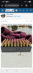

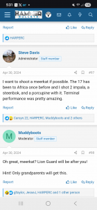

Steve Davis, owner of Hammer Bullets, killed 2 impala with the 19gr Hunter bullets using a 17 Hornet at 3,600fps.
