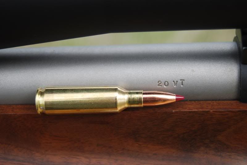

I have a 20VT [17 FB necked up to 20-cal] and there is no muzzle jump with mine and the muzzle blast is reduced significantly say from a 204-Ruger. My rifle is a REM 700 17FB SOS converted to 20VT. Couldn't be happier.

DoubleDraw: I shoot both Coopers and CZ's in 17AH, 17 Mach IV (same as 17FB), 20VT, 204R and up the caliber scale. That said, and not really knowing what your shooting will involve, I'd strongly advise a 20VT as an alternative.
It will do everything the 17FB will do, but do it better with better bullet selection too. The 17HH has problems from the factory, not solved entirely yet, but either the FB or the VT will outperform the Hornet cased version in every regard. Some of the smallest groups I've ever fired were from my Cooper 20VT. I seldom shoot my 17M4 or 17AH these days, much preferring the 20VT.
As I spend up to 50-60 days afield every year for grass rats and chucks, I've found the 20VT does it best with minimal powder used, zero recoil (see all your hits through the scope), amazing accuracy and a distinct lack of barrel heating.
