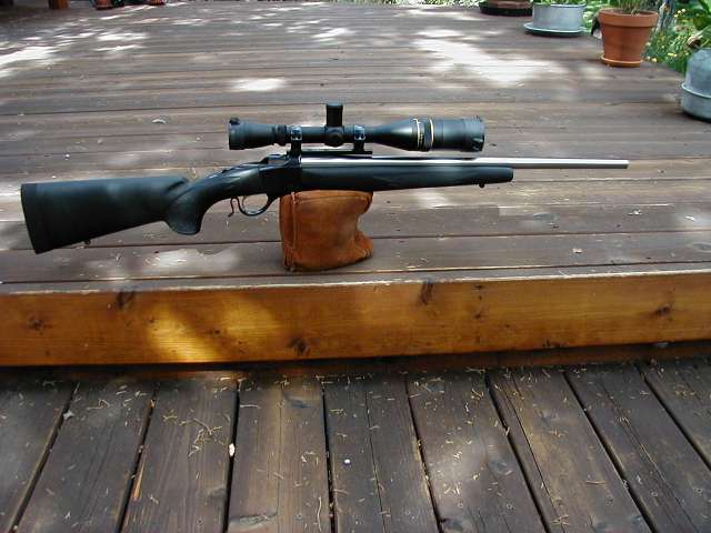

17AH, Ruger No.3 action, Pac-Nor SS Super Match 10T @ 22", B&C synthetic stock, bedded/floated. The thing is the same size as a 10-22, but worries ground squirrels out to 400.
