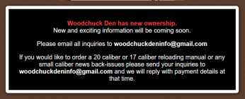

Somehow, I missed the news that someone picked up Todd's shop.
I know he wanted to retire and more or less closed down, but this latest header on the old web site looks like maybe somebody talked him into keeping the shop going?
