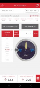

Anyone have to correct the BC of these? I have been shooting 108 ELDms and using the hornady 4DOF app but they don't list the VLD Target in their library so you have to manually enter the bc. I also noticed that using bergers program results in a different adjustment than the hornady app all things being inputed the same.
I plan on using the vlds in a prs match in a month or so and was hoping someone had been through this already. Thanks.
