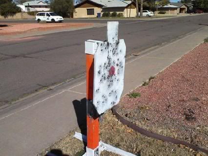

With my target as posted above which is all steel....the hits through a spotting scope from 1200 yards stand out like a 5 carat diamond shining in a Billygoats behind! The only time you need to drive to the target is to record/photo the impacts and to repaint!! :) ;D The white bull is AR400 and overall bull size matches the Palma/Creedmoor paper target for 800, 900, and 1000 yd. shooting! However it works well for shooting all the way back to 1600 yards.
LR Creedmoor Target by Sharps45 2 7/8, on Flickr
ricktarget02 by Sharps45 2 7/8, on Flickr
Well it sure holds up well I can only see one possible ding in the lower right 44" bull.
