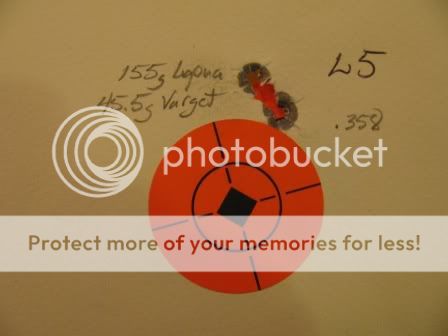

I would agree that Tikkas can shoot. Below is a 200y three-shot group from my new (to me) .308 Master Continental w/26" heavy barrel while doing some load testing recently:
I had only loaded three rounds with each charge, so I'm hoping it wasn't a fluke! At 45.5g of Varget the primers were starting to get a bit flat and there were faint impressions from the ejector and extractor cut-out on the case head - rifle has not been fired much, so there might yet be a sharp edge on those surfaces. Bolt lift was as easy as with other loads. Brand new Lapua brass, so it could have been a little extra head space. Next round of testing will be with once-fired brass.

John, nice groups with the .308, my 7mm-08 will shoot three just about the same, I am shopping for a 6.5X55 Swede, anyone have one of those yet in a Tikka? if so how did they ring out? Sorry Danley I blew the pic up and was sure it said 120, Stan my chicken scratch is much worse as I can't decipher my own chicken scratch ::) ::)
Wayne.
