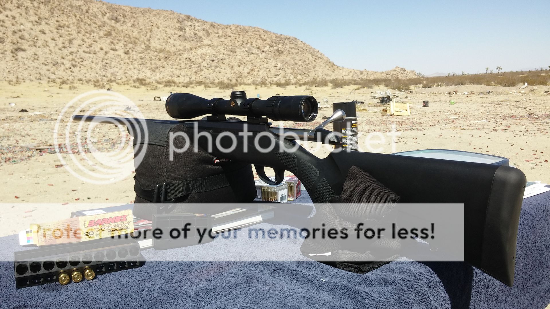

They are great shooters. I have a pair of twins. One in .243 and the other in .223. They both have bushnell 4200 2.5-10x40 now. Both were moa on the first day with cheap to moderately priced ammo. I use the .223 for jack rabbits and cheap practice. I use the .243 for predators, and eventually medium game if I ever draw a tag. I have had the .223 for about 10 years. It has taken countless jack rabbits, coyote, and a wild boar.
Picture of the jackrabbits almost looks like the Owens Valley in California.
