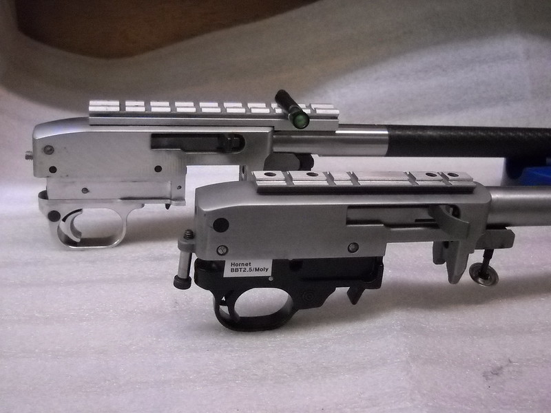

Do you need to upgrade the receiver to make a 10/22 more accurate - Not if you are using a slip fit barrel.
I've posted this pic a couple of times already
But, if you upgrade to a screw in barrel why not upgrade to an MOA receiver.
