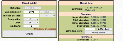

I think that it would depend on how well the barrel fit an unmodified action. If it was on the loose side for a standard action then that would be added to by .010. FYI, if the thread form of a 16 pitch thread comes to a point at the top and a V at the bottom, the height of the thread is .054. If we divide the .010 added looseness by two we get .005 per side. (V threads tend to center as they are tightened.) Of course barrel and for that matter action threads rarely come to sharp points so that needs to be taken into account when considering overlap. I am not telling you what you should do, just providing some information.
A .010 oversized on the pitch diameter would not be a safety issue.
Heck, I have taken Panda and Bat Barrels,(1.062 18 tpi), and established a 16 tpi on top of the 18 it to screw into a Remington use as a prairie dog rifle.
As to whether it would affect accuracy can be debatable. I have seen some pretty sloppy fit barrels that shot quite well.
Clearance is clearance. If tightened properly, a V thread will self center, whether there is .001 or .010 clearance.
