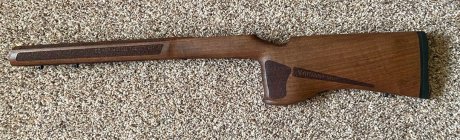

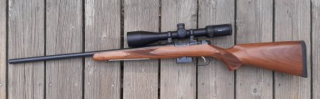

Here's my 17 Hornet and then the 557 Varmint Match Target Rifle MTR stock I'm looking at.
Don't have any idea if the actions fit the same stocks, assume probably not.

I don't have the other stock here, it's online. I was just hoping someone knew if the actions changed dimensions or design between the two models to tell me.

Different size actions. The 527 will likely physically go into that stock but there’d probably be lots of mods needed.
This is correct, the 550/557 were full-length actions, whereas the 527 is a mini. You’d have to back-fill a LOT of the inletting and re-do it for it to work.
The 527 came in an MTR stock as well, FYI. Probably harder to track down (most things to do with the 527 seem to be, aside from mags and rings), but they’re out there. I have a 527MTR, and while the stock is chunky, it’s also really comfortable IMO. Not as nice as say a McM A5, but for a factory wood stock they did alright IMO.
