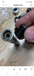

First, I have to correct myself. It's not a needle bearing, but you can see that in the image below.
Also, take note that the screw in portion of the shroud has an insert of some sort in it. It looks to be stainless steel.
I'd assume it's the size of a 38 Spl minus the primer hole. That probably rides against the bearing that is inserted into the bolt body.
I like the mods that he shows. It's very nice looking work.
The parts are either stainless or aluminum depending on the external finish. For the inside parts they are all stainless. Bearing cages are brass of course.
