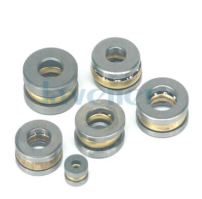

New Cheaper Lift Kit. Adjustable for preload.
You need a New Style BAS,
and Thrust Bearing Kits, From China, eBay, 10mm X 4mm, 10 for less than $10,
And a 38spl head, drilled, NO ball.
To increase spring preload or decrease preload (requires shaving New Style BAS).
Shave BAS if required, stack Thrust Bearings for internal length.
Gives access to Cocking Pin through BAS for Pin Fall measurement.
PIN FALL using new style BAS and shims with a hole for depth gauge through the BAS
