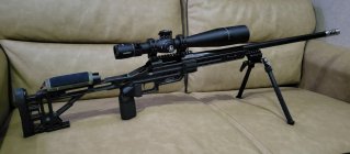

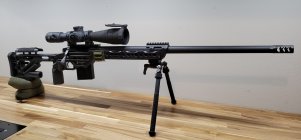

I built my first NRL hunter rifle to shoot the heavy class next month in San Diego. Really excited to try out this match format. I have been shooting PRS for a little while but this will be my first NRL hunter match
-Terminus Zues action with QC system
-Benchmark 6.5cm heavy Palma barrel
-EC tuner brake
-MPA hybrid chassis
-Leupold Mark 5, 5-25 with H59 reticle
-ARC rings
-Triggertech diamond trigger
-MDT CKYE pod single pull bipod
Rifle weighs 15.8#s for the heavy weight class.
I am shooting berger 140 hybrids at 2850fps that will give me a power factor of 399,000.
I plan to send thr chassis out for a camo paint job after the match. I have too many black rifles. Haha
Had to order a new barrel today before my match. This one would not shoot no matter how hard I tried. I found a Kreiger barrel and it should be here in a few days. Hopefully it either likes factory 140 ELDMs or my reloads because I won't have time to do full load development before the match.

This is my prs setup in 6cm

Got the new barrel on today and tested the 140 Hornady ELDM and my reloads for the last barrel. The new barrel liked my reloads so I am good to go now. Disaster avoided!

The company that cut the benchmark is going to cut me a replacement next week after explaining everything. I am having them chamber it in 6.5 SAUM since i already have a 6.5cm that works now.
