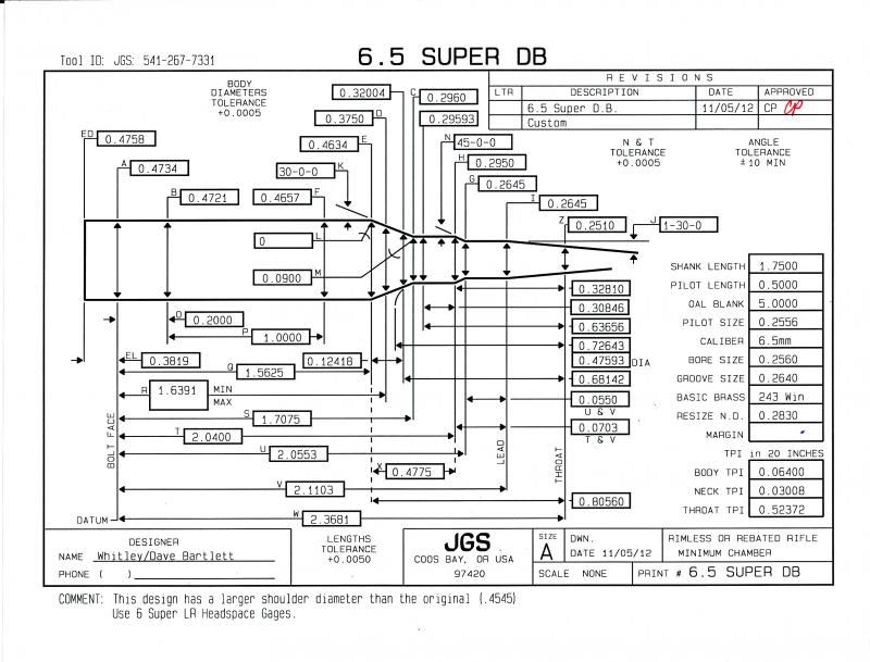

Well I just got back my chambered barrel.
I've processed a 100 cases for testing. I had deburred the flash holes, uniformed the primer pockets, chamfered the necks and annealed after sizing.
I used the Frankford Arsenal OAL Gauge and came up to similar measurements as posted on his website.
So how is mine "improved" (highly subjective since it is not tested)? I changed the dimensions to blow out some of the taper. I decided to try this since my 284 Shehane has worked so well, I figured why not try it on this as well?
The down side is 2 sets of Sizing dies.
My only concern is the extraction. If it extracts fine then I'm a happy camper. If it does not then I just sank a ton of $ just to learn one way not to do it.

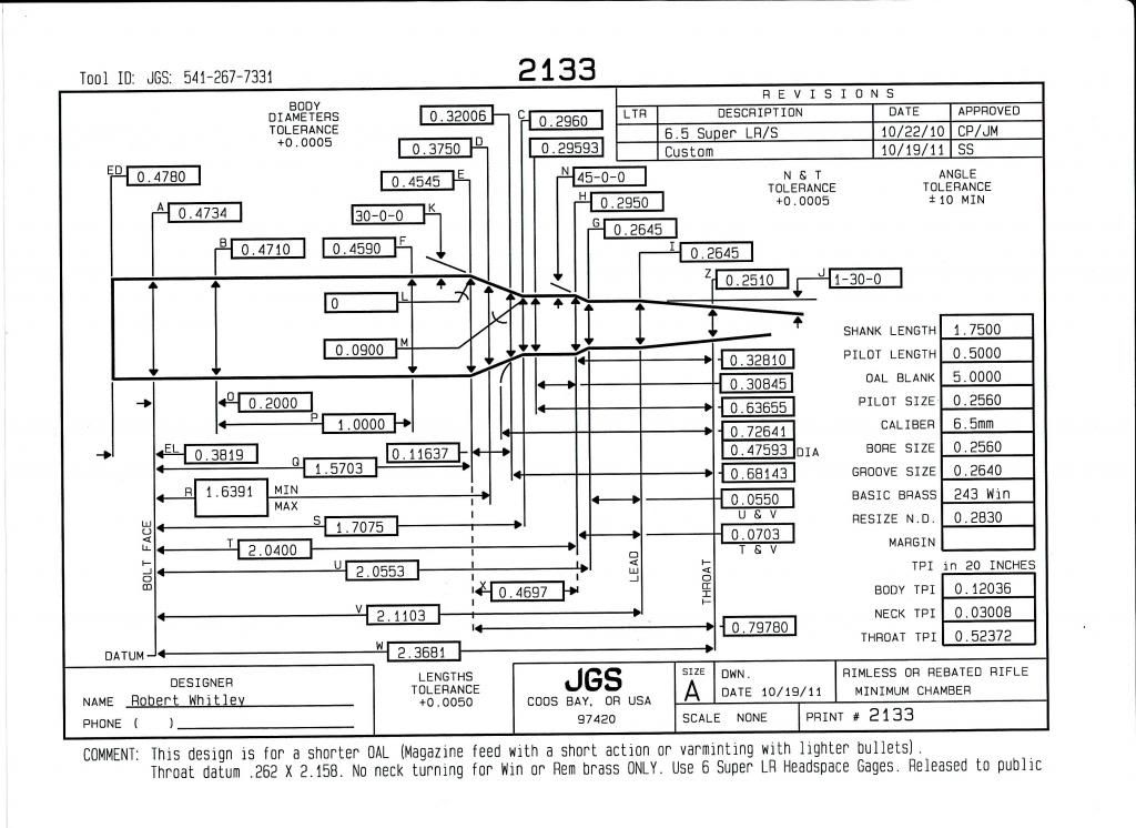

Thanks for info Dave...I'm interested in your project as I've been looking at the 6.5 SLR for awhile now. The shoulder on the standard SLR is 30 degrees, my understanding....approximately what angle do you think will be on your improved? and what loads/powder/bullet combo are you trying? Thanks much and Best Wishes
I said "improved" because it is slightly changed. I changed only the taper of the case, similar to the Shehane modifications to the 284 win case.
The shoulder remains the 30 degree of the original 6.5 Super LR/S.

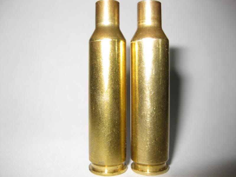

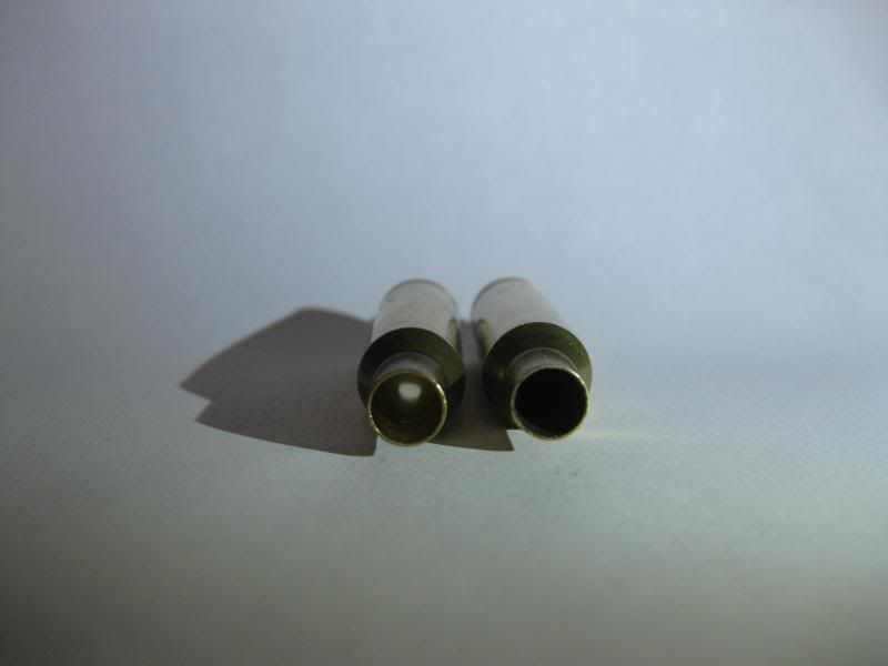

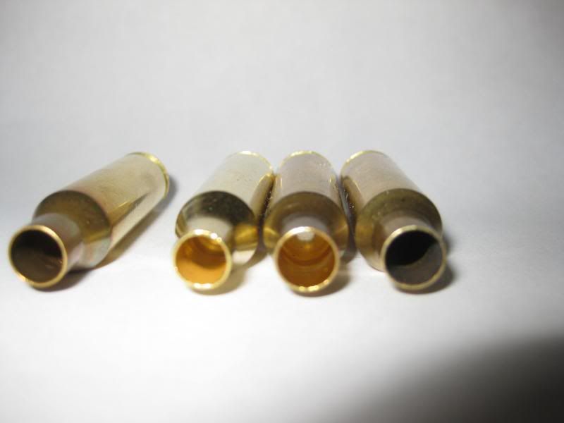

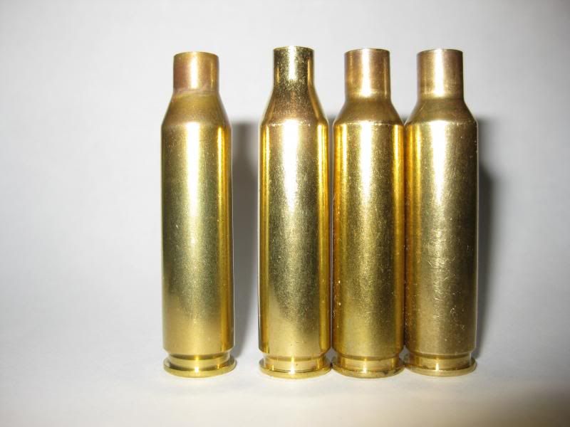

Just got to fire form one case and thought I'd post some comparative photo's
260REM-243WIN-6.5SLR-6.5SLR Imp
6.5SLR-6.5SLR Imp
6.5SLR-6.5SLR Improved
Great pics and info Dave...really like the looks of that case. How soon before some testing do you think??? Will be waiting for results for sure. Thanks again

The last picture of the case comparison series shows the change in taper the best.
