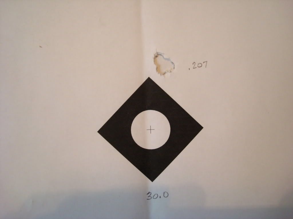

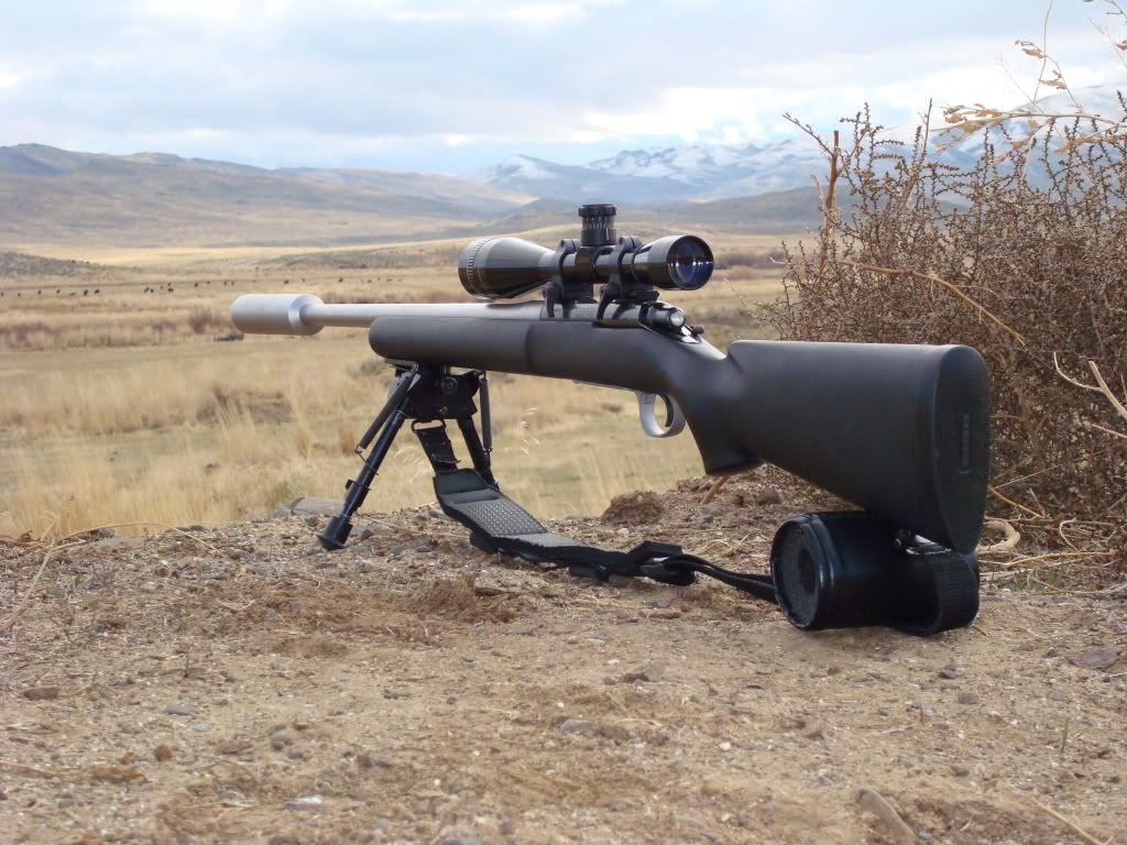

Why not go with an 8 twist and be able to shoot any bullet you like. Here's a nice group from my .22BR 8 twist shooting a 40 gr. V-max. Just a thought.
Regards, Paul
