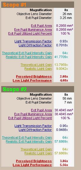

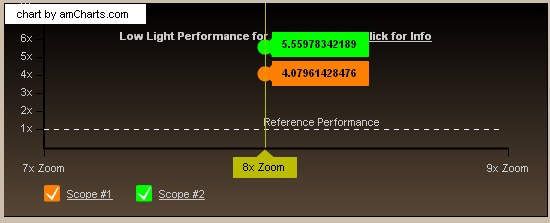

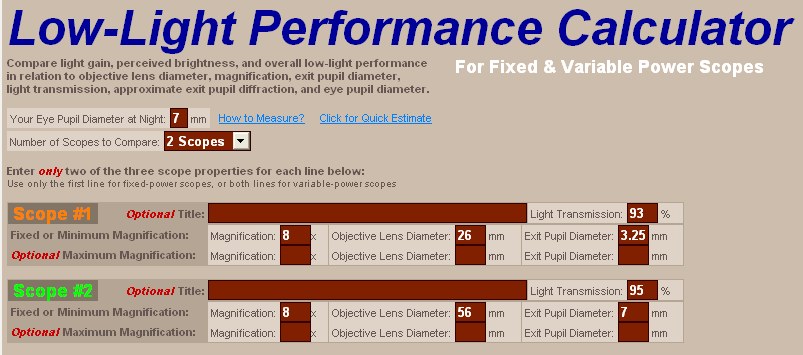

Scopecalc.com is an online calculator that will calculate the low-light performance,in terms of perceived brightness) of various optics. You can compare one to another. Ascribing a light transmission of 93% to the PRF,orange marker) and 95% to the Geovid,green marker), the difference in perceived low-light performance* is about 36%,4.08 vs. 5.56). That's a significant and useful gain, but it's not 500% better.
There is no question that the Geovid is a superb optic for hunting. However, it is misleading to say that the Geovid transmits 5 times as much light simply because it has a larger exit pupil. There is a reason makers of 56mm binoculars are NOT claiming such products deliver 500% more light,to the eye) than 26mm binoculars.
As any one can understand, you can have a lot of light energy in a small area,imagine a laser) or a weak amount of energy spread out over a larger area. Light gathering is generally a function of the size of the objective,other things being equal), but you also have to look at light transmission and the quality of the lens. Poor lenses may transmit 80% of available light, most scopes are around 90%, and the best may approach 95%.
I certainly don't contest that the Geovid is better for low light. But to suggest it delivers 5 times the absolute light energy whether in lumens or F-stop values is just wrong. You can confirm this youself with a spot light meter.
Again, I suggest that it is wrong to say that the Zeiss is 'practically useless' for hunting. That's going too far. Not all hunting is done at 'last light', and it some areas, night hunting is forbidden.
Returning to the original question. Yes, based on our testing so far, we are very impressed with the Zeiss PRF. It is as bright as any monocular LRF in the under $1000.00 consumer category.
The perceived low-light performance is calculated as follows:
'This calculation derives Low Light Performance as the average of light gain and resolution gain through magnification, as a measure of target image acuity gain in low light similar to Twilight Performance specified by scope manufacturers. Low Light Performance calculated here is much more useful than Twilight Performance, as Twilight performance is the average of the just the objective lens diameter times magnification, while Low Light Performance is the average of the actual Perceived Brightness times magnification, which also includes the exit pupil/eye pupil relation, light transmission, approximated diffraction, as well as the perception of relative light gain. Just as with Twilight Performance, this Low Light Performance calculation does not yet include lens resolution and contrast as factors. Therefore lower quality optics will yield relatively less gains at higher magnifications.
Low Light Performance =,Perceived Brightness x Magnification)^,1/2)'
