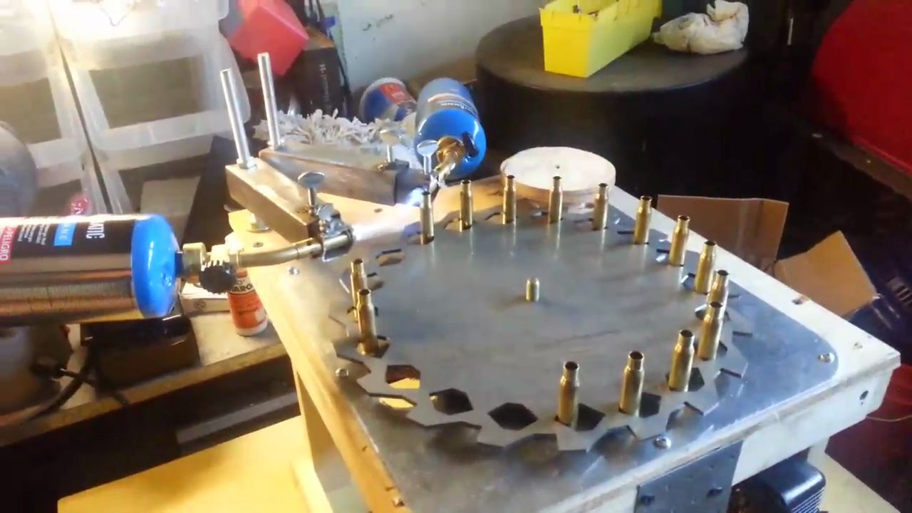

This is what I'm working on. I've got the motor, controller, 9 volt batt. power source and am waiting for the RepRap tooth pulleys and belt. I just have to mount it into a project enclosure (@8"x10"x4") and Bob's your uncle. Total cost will be @$50 (not including torch)
https://www.youtube.com/watch?v=dONsoESSdNc
That's excellent sir. I have made one similar but using a much smaller 4" drum.
This is a different set-up.
Here's my mark 3.
http://vidmg.photobucket.com/albums/v639/allan1066/anmk3_zpsd1f4e6c3.mp4
Who makes the M3 or is that a homemader? If it is homemade it is quite the cat's meow! Here is my homemader.

That's my machine Diego and thanks for the compliment. Yes, designed and built by me in my home workshop.
