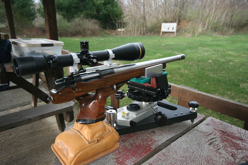

Recoil has nothing to do with it. Brake it if there is too much. I would not shoot an XP without a rifle scope. I shoot a Leupold 8.5-25 LRT on my 6BR XP. Go for it, you're fine.

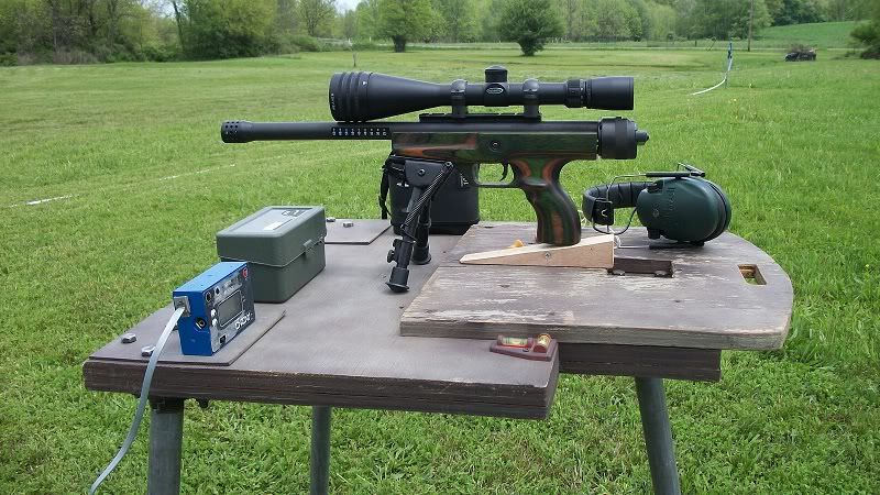

I have a 6.5-20 rifle scope on my Competitor 22-250

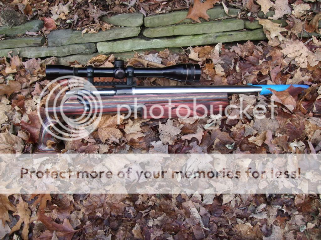

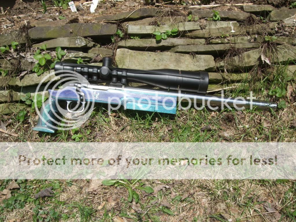

preacher, where did you get those stocks? is it hard to change from the center grip to a rear grip?
As far as the change over, all you really need is a rear grip trigger.. I have Jewells in most of mine, but a 700 trigger works just fine also..

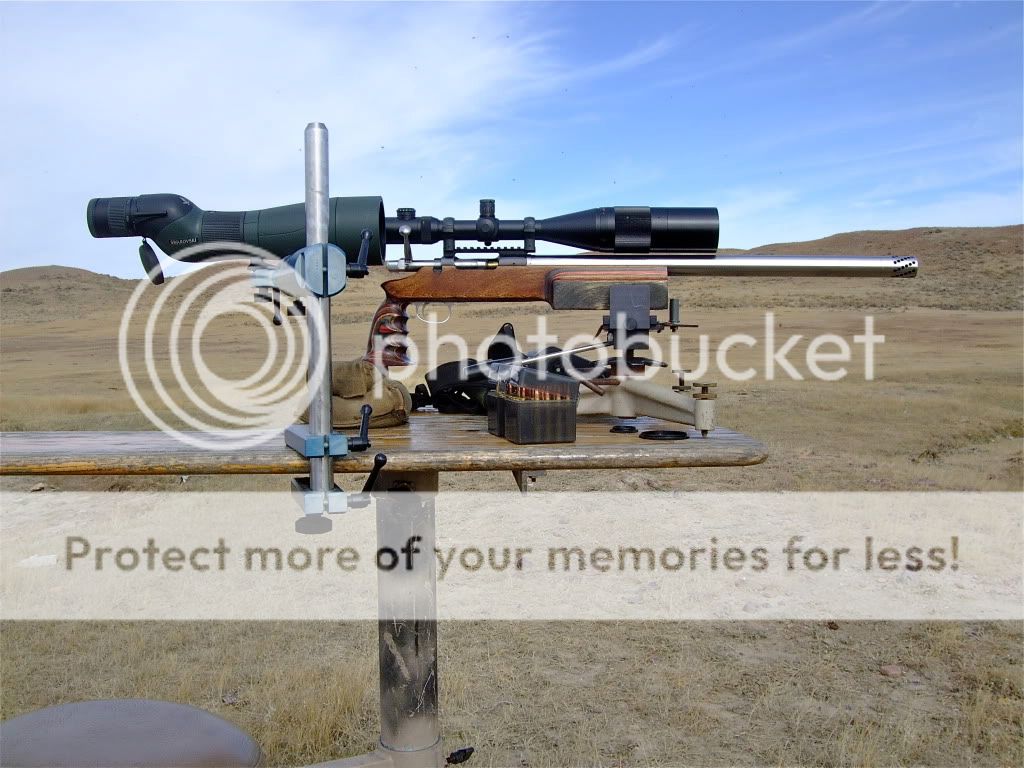

I have a Leupold extended eye relief scope on my Fireball and shoot it from arms length. I would hate to get and eye full of acope. My Fireball shoots sub 1. MOA out to 300 yards.

My rifle scoped Competitor 22-250 with muzzle brake has hardly any recoil. The muzzle moves up less than one inch. No danger of "scope eye" whatsoever.
