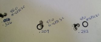

I own both but the way to go in my book with a rear trigger and use a Jewell BR model trigger. After all you'll be shooting a single shot you don't need a safety, ya can't be safety then leaving the bolt up until your ready to shoot. Here's my BFP "Big Friggen Pistol" it's a switch barrel chambered in 25-284 Win w/ brake for the deer stand and a 22BR for the p-dog towns. One piece of advise pay attention to any advice that Preacher put out, he built my XP-BFP and developed the 25-284 loads. He is the XP pistol Guru.
