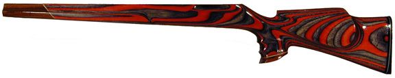

with a little imagination and squinting your eyes just right you might be able to see a xp-100 rear grip finger groove stock in this picture. of course it will require sone cutting , shaping and sanding. te pistol grio cut is pretty straigh forward and the front cut would probably be an anglke cut close to 35-45* and fron rear to front.
richards microfit inlets for the 600/660 and i'm pretty sure that was the stock i used on my xp 22 ppc.

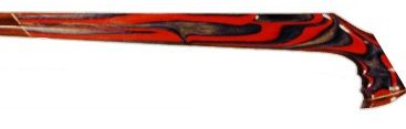

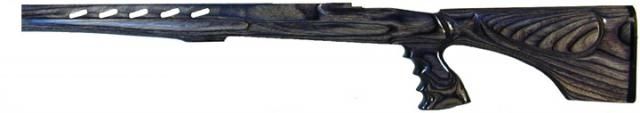

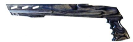

i have no doubt i can make it work with a minimum of work. Richards has the action pattern for the 600/660 and others they don't list. i am going to ask if they have the xp-100 or if they can inlet it for the 600 and not drill any holes. a rear escutcheons for the rear action screw will have to be bedded into the stock. the rear action screw goes down threw the top of the action. i will pillow bed the front action screw. cutting the stock looks pretty simple at the rear and some thought has to go into the front as to for-end length. i'm going to check and see if i can get the stock without the vents, life would be simpler.
as a guess i would say it would look like this by the time i get thru with sawing and sanding it will look like this;
or this
